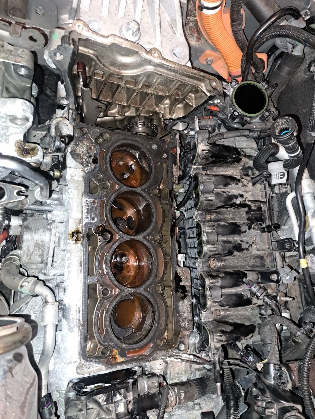

    3. You dont necessary need new engine, just have them remove the cyl head and inspect the valves. We just opened one with loose pulley and all valves were straight. If valves are bent, replace and reinstall the head. (also you could check if your old engine might be repairable)
    4. I did 2 first repairs by removing timing cover and oil pan, now with 3rd one in trying to perform the work without removing them, it may work but im not 100% sure yet, much easier if i can. This one had 6 exhaust valves in pieces.

  • Jamar: Remember you dont need to disassemble everything, just remove head and pistons if the valves have hit.
    If head is damaged, then either try to find used one (couple for sale at the moment) and i can help you getting the valves, pistons etc if needed. less than 1000 eur for the parts if head is ok, less than 500 if pistons are ok.
