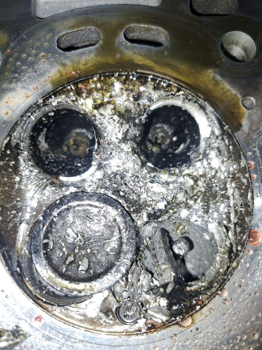

Took a long time but i finally got my 3rd project, compass 2020 with 53000 km done and inspected. For anyone doing valve replacement, you dont necessary need to remove oil pan and timing cover, just lift the cam, drop the chain down, remove that one bolt holding timing chain guide (most difficult part id say) then lift the head and repair as needed.

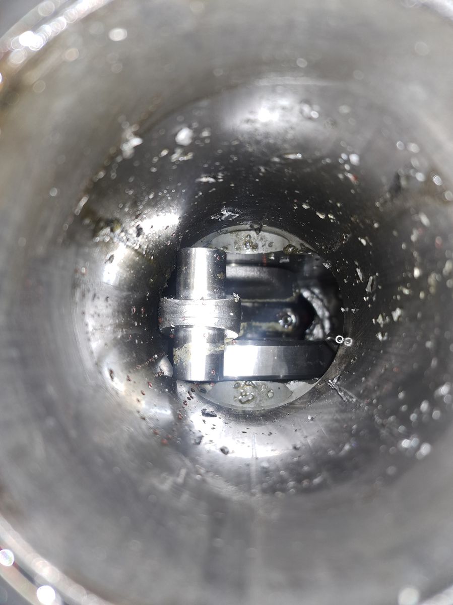

-If valves have hit pistons hard, replace pistons as they will be oval after hit(!!!)

Jamar: Remember you dont need to disassemble everything, just remove head and pistons if the valves have hit.
If head is damaged, then either try to find used one (couple for sale at the moment) and i can help you getting the valves, pistons etc if needed. less than 1000 eur for the parts if head is ok, less than 500 if pistons are ok.

4. I did 2 first repairs by removing timing cover and oil pan, now with 3rd one in trying to perform the work without removing them, it may work but im not 100% sure yet, much easier if i can. This one had 6 exhaust valves in pieces.

For the second Renegade 55000km i bought used engine from ebay, seller said it has running problem but i took the risk, well it was bad decision as i installed it and started and it failed right away, one piston was in oil pan and valves broken. Now waiting for more spares for this one.

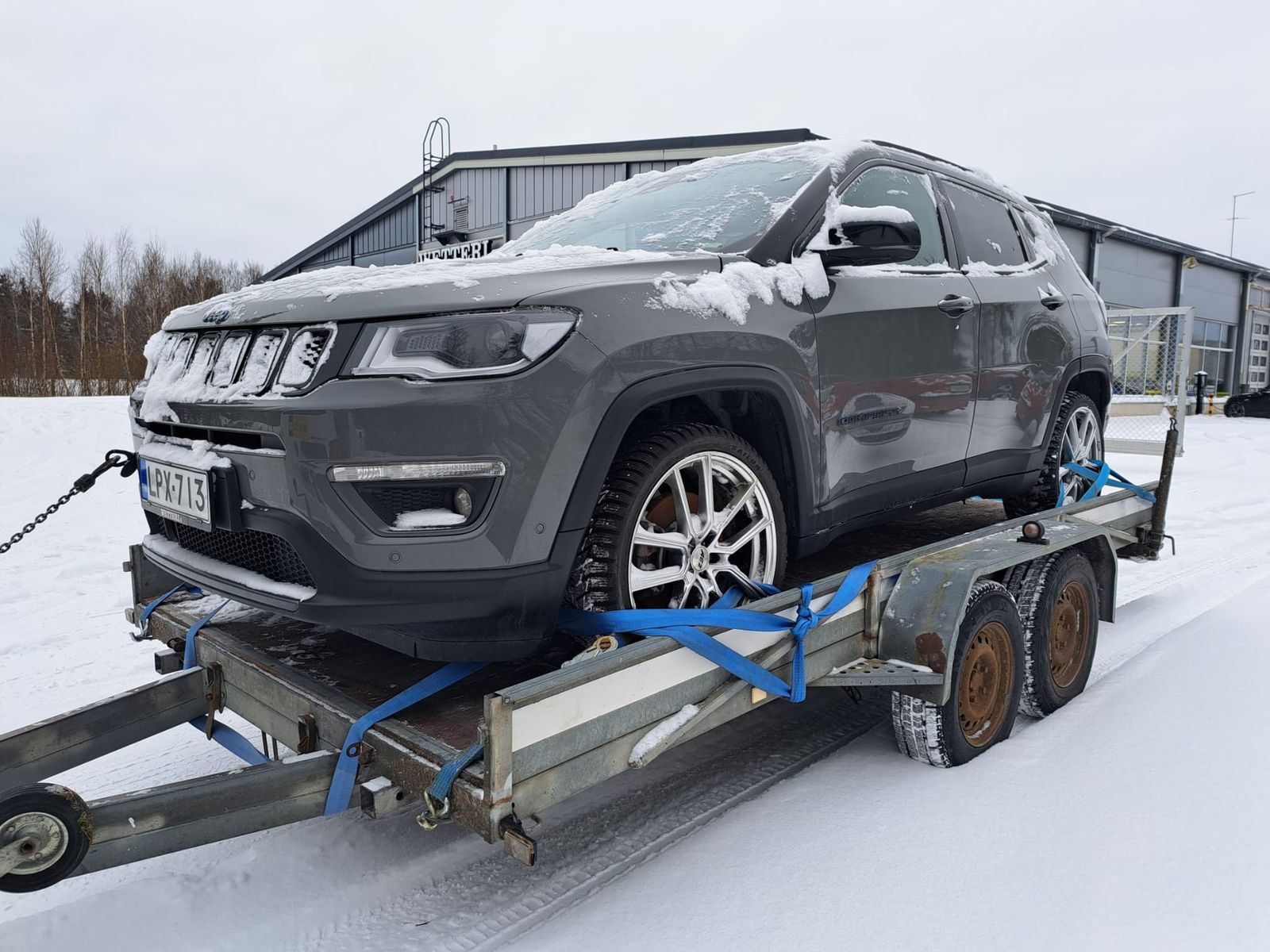

The third one, a Compass 52000km i have not even started the repairs yet.

About the pulleys getting loose, i know there are atleast 5 confirmed cases here on Renegade/Compass hybrids.
I own 3 cars, friend has 1 and i have seen few in auctions also. All these were out of warranty so cars are being sold in auctions.
Last saturday went to pick up my latest purchase 2020 Compass with 52000 km i met mechanic while loading the car, discussed with him and mentioned about the 5 cases i have seen, he laughed and said there is atleast 50 cases...
