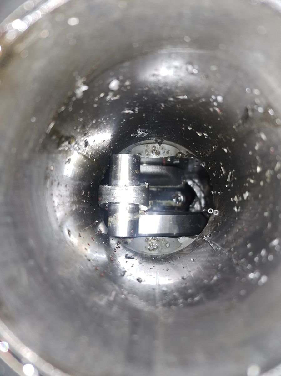

  • I repaired one Renegade 72000km with used head from Ukraine, 4 new pistons and head gasket from ebay. Gave the car to my mom and she has been using it a while now.
    For the second Renegade 55000km i bought used engine from ebay, seller said it has running problem but i took the risk, well it was bad decision as i installed it and started and it failed right away, one piston was in oil pan and valves broken. Now waiting for more spares for this one.
    The third one, a Compass 52000km i have not even started the repairs yet.
    Anyone who has one of these, at least 2020 models, i would strongly suggest to inspect the Crankshaft damper bolt tightness or to have it inspected.
    There is no key in the crank pulley or crank chain sprocket so when the alternator (that is used also for primary starting the engine) turns the engine, the bolt may loosen and cause catastrophic failure (bolt has reverse thread).
