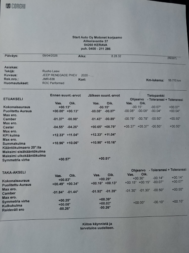

2020 Renegade 4xe wheel alignment specs
  • Hello, would anyone have correct specs for the Renegade? Tried to get my car aligned but i think they messed up something and would like to know if they used correct specs.
    Also, can front/rear camber be adjusted by loosening the bolts and moving subframes left/right to even out the camber?
    (on older compasses this was possible due to large mounting holes)
